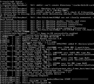

Initially I tried without a wipe, I got as far as the unlock screen, but with no wallpaper, it seemed to hang.
I wiped, reflashed, wiped again but it still wont work. It stops after just a minute in the logcat (pic 1 attached)
I tried again and I've posted a pic of the initial errors.

did you wipe the data, dalvik and any ext2 (App2SD partition) caches as well? Edited by cortez
Guest AndyCr15
I didn't wipe Apps2SD partition. How do I wipe just that?

Cool, that worked :P
