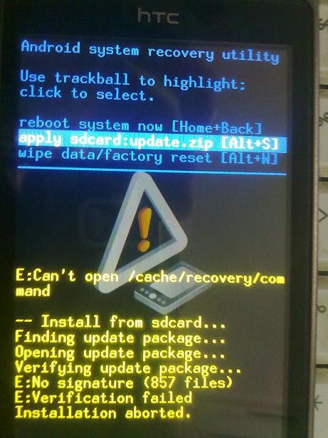

Guest siamak5561 Posted May 6, 2010 Report Posted May 6, 2010 Hi friends, first sorry for my bad English I rooted my phone with Instant_Root_v1.00.zip and i was mistake and deleted fonts on "\system\fonts". later turn off and turn on phone and my phone stop on logo of HERO :D . I try to flash with method of "update.zip" but had a Error of Signature! :P and this is pic of my phone Press POWER+HOME after Press POWER+HOME again and when i try to flash with Update.zip please help me how i alive my phone
Guest Roton Posted May 7, 2010 Report Posted May 7, 2010 Have you tried to put a signed image on the microsd card (using your pc) and rename it to update.zip. Then flash it from the menu in the photo?

Guest siamak5561 Posted May 7, 2010 Report Posted May 7, 2010 (edited) Masters i download many roms on this site and all of them when i'm go to flash with "update.zip method" have error of signature( i show in first post, 3rd pic) , what can i do for my phone ??? please help me. :P Edited May 7, 2010 by siamak5561

Guest siamak5561 Posted May 8, 2010 Report Posted May 8, 2010 (edited) I dont sure my phone root with instant root but when i press HOME+POWER this pic apear on my phone and my rom is original of HTC and i think "HTC Generic 2.73.405.66" ( i dont sure) Edited May 8, 2010 by siamak5561
Guest Dr. dre Posted May 8, 2010 Report Posted May 8, 2010 I dont sure my phone root with instant root but when i press HOME+POWER this pic apear on my phone and my rom is original of HTC and i think "HTC Generic 2.73.405.66" ( i dont sure) Have you tried wiping data/factory reset and then flashing a ROM.

Guest siamak5561 Posted May 8, 2010 Report Posted May 8, 2010 (edited) Have you tried wiping data/factory reset and then flashing a ROM. yes i do Do it from the phone, turn the phone off and then hold the Back key down and press the power button. You will be in fastboot mode. yes bro I in fastboot mode but the pc show me this message. Edited May 8, 2010 by siamak5561

Guest salahag Posted May 9, 2010 Report Posted May 9, 2010 Is that the correct recovery version for the Hero? on mine I don't see the Keyboard shortcuts!!!! since there's no keyboard obviously!

Guest Posted May 10, 2010 Report Posted May 10, 2010 Is that the correct recovery version for the Hero? on mine I don't see the Keyboard shortcuts!!!! since there's no keyboard obviously! I wondered that, it looks like you have installed an early Amon Ra recovery ROM for the G1. The latest recovery ROM has a lot of extra features. You may want to make a goldcard in case the signatures of the ROMs you are trying to install conflict with the phone, the goldcard circumvents that.
Guest siamak5561 Posted May 10, 2010 Report Posted May 10, 2010 You may want to make a goldcard in case the signatures of the ROMs you are trying to install conflict with the phone, the goldcard circumvents that. please more explain for me .
