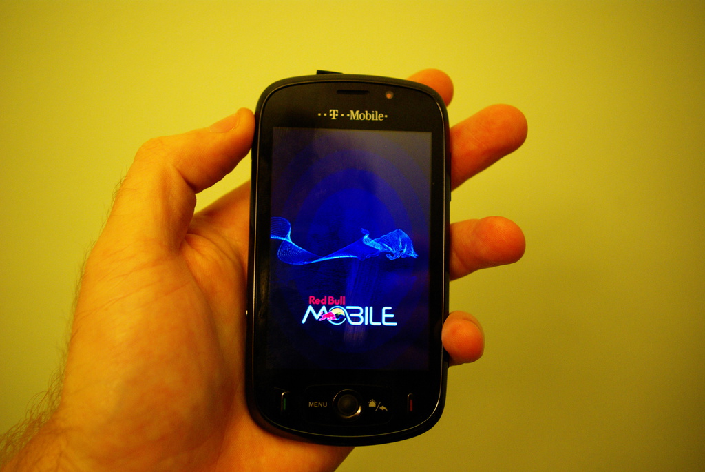

Guest Tom G Posted May 28, 2010 Report Posted May 28, 2010 So i've got it booted on my Pulse :( The screen works fine, but space is a problem... /dev: 53808K total, 12K used, 53796K available (block size 4096) /sqlite_stmt_journals: 4096K total, 0K used, 4096K available (block size 4096) /system: 87040K total, 82704K used, 4336K available (block size 4096) /data: 107776K total, 97184K used, 10592K available (block size 4096) /cache: 20480K total, 1164K used, 19316K available (block size 4096) /sdcard: 1479512K total, 1378508K used, 101004K available (block size 4096) and I already removed apps to make it fit. I will do a bit of testing and upload a rooted rom, but it might not be until tomorrow (its just past midnight here).

Guest Tom G Posted May 28, 2010 Report Posted May 28, 2010 Will this rom work on U8220? Yes. Its working fine on mine. So far no FCs or reboots :(

Guest Tom G Posted May 28, 2010 Report Posted May 28, 2010 All good so far. It does get one error when it boots about keyboard, but that should be fixable. There are a few more apps that could be removed to free up space but I still don't think it will be enough long term. Maybe we can move dalvik-cache to sdcard. The only thing I have found so far that doesn't work is vibrate (I haven't done the fix that was identified for the leaked rom). I will start uploading my rom in minute, but the link won't be up until I wake up tomorrow (it is now past 1AM here). Its rooted and includes busybox plus a few other things, but no a2sd yet.
