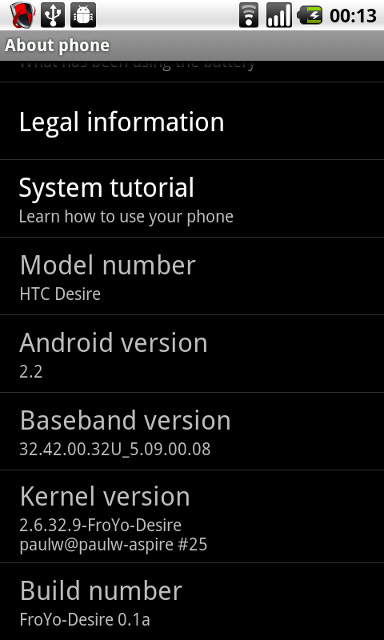

I've managed to get a fairly good working build now of FRF91 from AOSP. I was inspired mainly by both AdamG and meLIanTQ for there excellent work on both there AOSP built ROM's, so thought I'd have a go at it myself, so here is the result :angry:
I'm building this ROM to suit my own personal needs, with various little things thrown in for good measure, but it will remain 100% AOSP source. No APK's will be modified *after* the build, all customisation on my part will be done via the overlay.
THIS IS NOT A SENSE-BASED ROM
ROM Details
  • Built from latest AOSP source. (FRF-91 2.2-r1.1)
  • 2.1Mb Kernel Image Size so hopefully no problems for people with Bad Blocks :D
  • Kernel Base - 2.6.32.9 configured and compiled by myself (UV Support, no OC)
  • Self-modded Kernel Fix to keep phone charged at 100% while plugged in (used to drop to 89% and charge) (details >here<)
  • ext2, ext3 and ext4 support
  • cifs.ko, tun.ko and openvpn
  • Classic A2SD+ from my original dalvik-cache mod from Rooted 2.1 Eclair for Desire (details >here<) Copies Apps, App-Private and Dalvik-Cache to SD.
  • A2SD Fixed to help prevent White Screen Hangs (working with ext2 and ext3 partitions, needs testing with ext4)
  • Latest BusyBox (1.16.2)
  • Rooted with latest SuperUser 2.2 apk
  • Massive APN List
  • h264 Camcorder
  • Latest FRF91 Google Apps
  • 3G/H Icon Fix to display H during HSDPA connection.
  • Default Launcher is LauncherPro Beta
  • WaveSecure installed to /system/app
  • setcpu.txt copied to sdcard JUST incase you want to use SetCPU to ramp down the CPU Speeds to help conserve battery life (remember, no OC or UV support in kernel, but I do intend to patch UV support in future releases)
    • Facebook (Installable from Market)
    • Twitter (Installable from Market)
    • Original Android Launcher
    • Amazon MP3 (Installable from Market)

Echo not fixed in this ROM with the latest radio (32.42.00.32U_5.09.00.08).
I've tried alot of Roms that state they've fixed the issue. But every time i test it, it fails and sometimes miserably :(
I find the other end of the call hears an echo of their voice when they talk loud into their mic.

Just did a full wipe and flashed 0.4b - Still got the echo :(
Guest PaulW21781
You need to be using the 5.xx RADIO's with this ROM.
Guest OneCheekyDevil
I've been testing all ROMs with radio 32.42.00.32U_5.09.00.08
Is this not the latest ROM?
Have you tried calling someone, and getting them to talk loudly to see if they can hear themselves echo?
