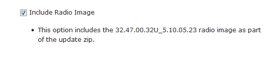

Guest fireblade84 Posted September 16, 2010 Report Posted September 16, 2010 why do you use the radio version 32.44 and not the 32.47?
Guest EddyOS Posted September 16, 2010 Report Posted September 16, 2010 why do you use the radio version 32.44 and not the 32.47?

Guest choccy Posted September 16, 2010 Report Posted September 16, 2010 Hey guys, I'm using the R8 Rom at present and it's using Radio Version 32.44.00.32u_5.09.05.30_2 Is there another version out I can use now on the R8 rom? Ta
