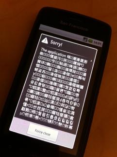

Guest Tom G Posted October 3, 2010 Report Posted October 3, 2010 Ah yes.... how hard can it be .... :) Change ro.product.locale.language=zh in build.prop to ro.product.locale.language=en The error messages might be a bit easier to read. ;)
Guest Sebastian404 Posted October 3, 2010 Report Posted October 3, 2010 (edited) Ok, So doing it correctly this time and erasing the system partition before I started... booting from the standard kernel it just sits on the Android Spash logo... and well you can see what happens from the kmsg. Booting it from the kernel that came with the dump, it progresses further down the process showing a boot animation (with sound!), but sits there forever, you can see the kmsg from that too..2.6.29___kmsg.txt2.6.32.9_perf___kmsg.txt Edited October 3, 2010 by Sebastian404
