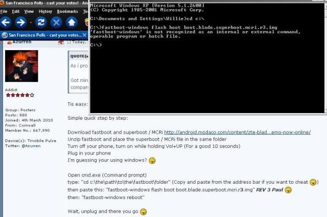

Guest feckineejit Posted October 4, 2010 Report Posted October 4, 2010 (edited) Hello again, i was trying to follow Azurren post, i downloaded fastboot and superboot / MCRi, unzipped fastboot and placed the superboot / MCRi file in the same folder, then moved it to my c:\ i don't have any thing after the c:\ as that is where i put it for convinence for myself. I then opened a cmd and typed in c:\ hit enter then typed fastboot-windows flash boot boot.blade.superboot.mcri.r3.img and then it came up saying not recognized. cmd problem anyone any ideas what i need to do? P.S sorry for the small pic. Edited October 4, 2010 by feckineejit
Guest Azurren Posted October 4, 2010 Report Posted October 4, 2010 Hello again, i was trying to follow Azurren post, i downloaded fastboot and superboot / MCRi, unzipped fastboot and placed the superboot / MCRi file in the same folder, then moved it to my c:\ i don't have any thing after the c:\ as that is where i put it for convinence for myself. I then opened a cmd and typed in c:\ hit enter then typed fastboot-windows flash boot boot.blade.superboot.mcri.r3.img and then it came up saying not recognized. cmd problem anyone any ideas what i need to do? P.S sorry for the small pic. Did you copy the folder to C:\ or the files? If the folder: cd C:\fastboot If you copied the files (What a mess) then make sure they are all there
