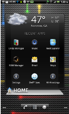

Guest mellytime Posted November 5, 2010 Report Posted November 5, 2010 (edited) DJ-Steve Great Job!! This worked like a CHARM for me. Once you apply the amss.mbn this thing kicks patudie :) My co-worker is as we speak trying to order one from Dell or BestBuys. This is wonderful and the instructions were dead on.... Now If you are like me then you want this process to be simple so here is what I did... 1- I went into Clockwork 2.5.0.4 using ROM Manager Premium and did a backup of my current 1.1.1 rom ( which was working fine ) 2. I performed a Whipe of Delv Cache, and Battery Stats I did not do a whipe of my Data. 3. Loaded the nebb update to my SD Card 4. Held both VOLUME buttons and POWER to get into recovery mode 5. Selected the SD Card update 6. Found the nebb update zip and installed 7. Rebooted boot time seemed normal to me maybe about 15 seconds 8. Fastboot POWER AND CAMERA went into Fastboot then while in CMD.exe going to the folder where I downloaded the amss.mbn I typed-- fastboot -i 0x413c flash amss amss.mbn " let this run til it finishes " Then fastboot -i 0x413c reboot 9. Reboot you get this Simple... I'm getting good that follow Instructions THANKS!!!! Edited November 5, 2010 by mellytime
