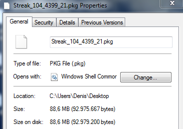

Guest sianto Posted October 28, 2010 Report Posted October 28, 2010 Hi, I just purchased streak with 6267 (00EU) version. I read everywhere, that it is indeed upgradeable to 2.1 then 2.2 I followed instructions at the other thread. Problem is, just after i flashed Update.pkg (Streak_104_4399_21.pkg), it says "software is up to date. Rebooting in 30 secs", and after rebooting, it actually still is 6267 !!! :mad::mad::mad: I tried for more than 5 times. All same results. I also tried to factory reset, re-fastboot, re-flash recovery, then re-flash ROM. Still same results !! It still is 6267 after reboot.. Anyone knows which part I have gone wrong ?? Please guide me... I badly want my streak to go 2.2.
Guest ShinyBallBoy Posted October 28, 2010 Report Posted October 28, 2010 Hi, I just purchased streak with 6267 (00EU) version. I read everywhere, that it is indeed upgradeable to 2.1 then 2.2 I followed instructions at the other thread. Problem is, just after i flashed Update.pkg (Streak_104_4399_21.pkg), it says "software is up to date. Rebooting in 30 secs", and after rebooting, it actually still is 6267 !!! :mad::mad::mad: I tried for more than 5 times. All same results. I also tried to factory reset, re-fastboot, re-flash recovery, then re-flash ROM. Still same results !! It still is 6267 after reboot.. Anyone knows which part I have gone wrong ?? Please guide me... I badly want my streak to go 2.2. I think you only flashed stock recovery, what's the size of Streak_104_4399_21.pkg?
Guest sianto Posted October 29, 2010 Report Posted October 29, 2010 I think you only flashed stock recovery, what's the size of Streak_104_4399_21.pkg? wrong ones ?? this is the one i renamed to Update.pkg and put in sd card..
