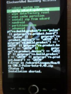

Guest rahadianbandhot Posted January 21, 2011 Report Posted January 21, 2011 Hi.I can't install it. When I did step"5. "install zip from sdcard" then "choose zip from sdcard" then scroll to "CM61-Pulse-0.40-tweak.zip" and "Yes - Install CM61-Pulse-0.40-tweak.zip"" ================================================ I:Verified system/media/audio/ui/KeypressStandard.ogg I:Verified system/lib/libGLESv1_CM.so Installing update... I:read: ui_print Welcome to CyanogenMod-6.1.0-RC2-Pulse! Welcome to CyanogenMod-6.1.0-RC2-Pulse!script aborted: assert failed: getprop("ro.product.device") == "pulse" || getprop("ro.build.product") == "pulse" || getprop("ro.product.board") == "pulse" || getprop("ro.product.device") == "u8220" || getprop("ro.build.product") == "u8220" || getprop("ro.product.board") == "u8220" || getprop("ro.product.device") == "u8230" || getprop("ro.build.product") == "u8230" || getprop("ro.product.board") == "u8230" I:read: ui_print I:read: ui_print assert failed: getprop("ro.product.device") == "pulse" || getprop("ro.bassert failed: getprop("ro.product.device") == "pulse" || getprop("ro.bI:read: uild.product") == "pulse" || getprop("ro.product.board") == "pulse" || E:unknown command [uild.product")] I:read: ui_print getprop("ro.product.device") == "u8220" || getprop("ro.build.pro getprop("ro.product.device") == "u8220" || getprop("ro.build.proI:read: duct") == "u8220" || getprop("ro.product.board") == "u8220" || E:unknown command [duct")] I:read: ui_print getprop("ro.product.device") == "u8230" || getprop("ro.build.pro getprop("ro.product.device") == "u8230" || getprop("ro.build.proI:read: duct") == "u8230" || getprop("ro.product.board") == "u8230" E:unknown command [duct")] I:read: ui_print E:Error in /sdcard/CM6.1-Pulse-beta-0.40.zip (Status 7) Installation aborted. =========================================== What can I do? MyPhone TYPE is CHT8000 already is T-mobile2.1 Offical Ver. I also experienced the same thing, and I've been using the rom u8220 -U8220V100R001C85B003 (Hungarian) -U8220V100R001C125B822_2_1_Eclair_Sweden_H3G -UK -U8220V100R001C32B820b (Venezuela Movilnet) but it still can not install the rom MyPhone TYPE is U8230 anyone can help? The following picture sorry my english is very bad
