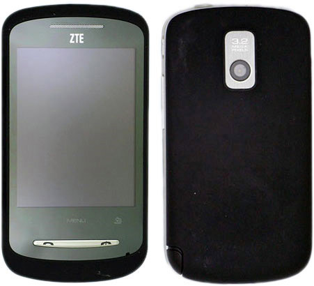

Guest equiliym Posted March 10, 2011 Report Posted March 10, 2011 couldnt we get some one to do a rom dump for x850 to help?? isnt x850 same as racer wtf
Guest Ang3l0912 Posted March 10, 2011 Report Posted March 10, 2011 isnt x850 same as racer wtf this is getting very confusing
Guest equiliym Posted March 10, 2011 Report Posted March 10, 2011 this is getting very confusing zte x850 zte racer looks the same to me, i dunno
Guest Ang3l0912 Posted March 10, 2011 Report Posted March 10, 2011 zte x850 zte racer looks the same to me, i dunno only thing different is the fact x850 has stylus:P
Guest equiliym Posted March 10, 2011 Report Posted March 10, 2011 only thing different is the fact x850 has stylus:P >.<
Guest Ang3l0912 Posted March 10, 2011 Report Posted March 10, 2011 >.< but hell no could be more to it software wise lol
Guest rickywyatt Posted March 10, 2011 Report Posted March 10, 2011 The racer and the x850 are the same if you flash the Chinese 1.2 rom it boots only the ril is brocken but if you do a t.p.t of the chinese rom you can fix the ril
Guest Ang3l0912 Posted March 10, 2011 Report Posted March 10, 2011 The racer and the x850 are the same if you flash the Chinese 1.2 rom it boots only the ril is brocken but if you do a t.p.t of the chinese rom you can fix the ril huh?
Guest hiperborean Posted March 10, 2011 Report Posted March 10, 2011 x850 and Racer are same device.. So how far have you guys come with the 2.2 ROM? If camera is the only thing that's not working, than afaic ROM is done! Camera is so crappy that it won't hurt a bit not to have it working :-D
