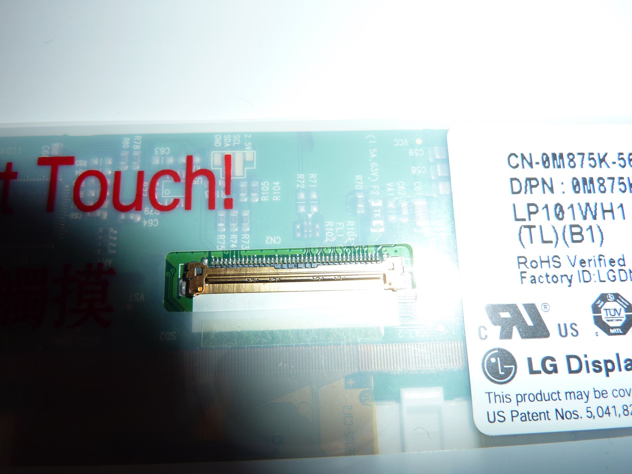

Guest dagrim1 Posted April 1, 2011 Report Posted April 1, 2011 Ight, gave it another spin... Again no success, screen lighted up... But other then that nothing. Booted it wih hdmi cable attatched and saw that it booted (used the CM7 rom btw) and started fine but no display on the lcd. Attached some pics to show the different parts. Any comments are welcome but I simply guess it's a no-go..
