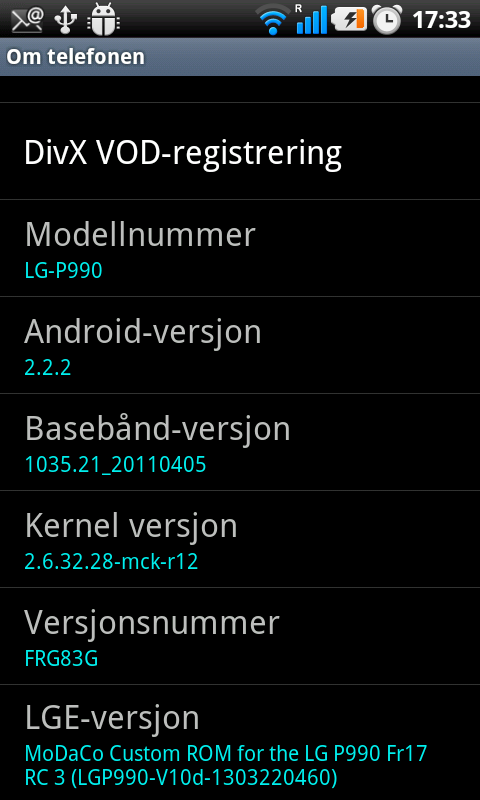

Guest Trym Hansen Posted May 19, 2011 Report Posted May 19, 2011 (edited) Help me diagnose the auto brightness problem. If you have the issue, please download this file - http://gordon.modaco.com/boot.Fr16.img - then do the following via ADB: adb push boot.Fr16.img /data/local/ adb shell dd if=/data/local/boot.Fr16.img of=/dev/block/mmcblk0p5 adb reboot This will break your WiFi (you'll need to flash Fr17 back afterwards), but hopefully will the Fr16 boot is on your auto brightness will work, in which case i'll be able to confirm it's a kernel issue. Could someone try with Eternity kernel too? TIA. P Done. Er, not sure what to say here. Wi-Fi NOT broken. Auto-brightness increasing slightly if shining a bright light directly at the sensor, but not dimming when covering the sensor in a moderately lit room. ::Trym Edited May 19, 2011 by Trym Hansen

Guest Paul Posted May 19, 2011 Report Posted May 19, 2011 Done. Er, not sure what to say here. Wi-Fi NOT broken. Auto-brightness increasing slightly if shining a bright light directly at the sensor, but not dimming when covering the sensor in a moderately lit room. ::Trym After flashing the Fr16 kernel above? Does it now show 'mck-r12' in settings->about? P
Guest Trym Hansen Posted May 19, 2011 Report Posted May 19, 2011 (edited) After flashing the Fr16 kernel above? Does it now show 'mck-r12' in settings->about? P Yes, it does. "2.6.32.28-mck-r12" to be precise. ::Trym Edited May 19, 2011 by Trym Hansen
