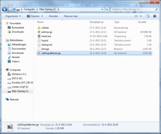

Guest hayabusagr Posted May 18, 2011 Report Posted May 18, 2011 (edited) Step-by-step: Install android on SD-card 1. Requirements You will need the files below before you proceed: Android installation 2D/3D drivers B7610 support files 2. Unpacking files You will need the 3 downloaded files, so I recommend to unpack them to a location that isn't that hard to find. You can unzip it like this: 3. Putting the files on 'My storage' Put the phone into 'Mass storage' and select 'My Storage'. You will see it on Windows (computer): Copy the contents from 'Froyo_beta1_1024' to 'My Storage' likt this: 4. Install Android First, unplug your phone from the computer. NOTE: You will need more than 1GB of free space on your SD-card before proceeding! On your phone, open your file manager and go to 'My storage'. Next, open the folder 'o2beta'. You will see 4 files: haret.exe, sd.cpio.gz, startup.txt, zImage. Launch haret.exe and click 'Run'. If the installation fails, look at the error message and check the 'known issues below this post'. Your phone will now reboot back into Windows Mobile. 5. Installing updates Plug your phone back in, so you get the 'My Storage' on your computer. Copy the file I selected in the screenshot below to 'My Storage': You will now have the following in 'My Storage': Unplug the phone again Go back into the filemanager on your phone, and launch the haret.exe on your 'My Storage'. NOT the one you used in step 4, but the one next to the log.txt. You will now see Android boot (It can take about 5 minutes the first time..). Once you can use Android, DO NOT do anything. Instead, hold the END_CALL (Hangup) button and press 'Reboot' or 'Shutdown'. You are now back in Windows Mobile. 6. Install support files for B7610 Hook up the phone to your computer (yes, again! I promise this is the last time). Go into your downloaded files folder, and select these files: Copy those to 'My storage'. You will get a warning that 'zImage' already exists, overwrite it. Check if you have the same as me: Unplug your phone, and launch haret.exe like you did in step 5. (From my storage, not from o2beta folder!) Enjoy :-) Hello and thanks for the detailed guide. I would like to ask you how much time it takes for the phone to move from step 4 to the reboot. I mean, I run HaRET, the linux boots, but even if I wait for 15-20 minutes it seems to stack and never reboots. Does it need more time ? Thank you in advance Edited May 18, 2011 by hayabusagr
Guest Headie690 Posted May 18, 2011 Report Posted May 18, 2011 I don't have any "log.txt". And if i try to boot Android, it seems like it just freezes. Perhaps because of the missing file. Why I don't have this File ? I think i have done everything, like describend in the tutorial. Can anybody help me please ?
