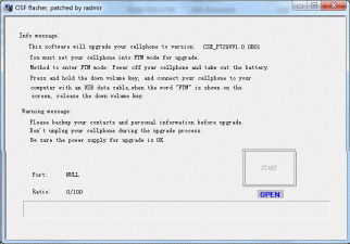

Guest wbaw Posted April 24, 2011 Report Posted April 24, 2011 (edited) The ram is locked by appsboot.mbn the only known way to flash that to a proper Gen2 phone is using the Windows software. Glad that it works on Greek Blades, now what about Chinese X880's ... we already have the Chinese mbn files, so if it goes horribly wrong it should be recoverable. They should be able to mix the Chinese mbn files with just the Swedish appsboot.mbn appsboothd & partition_zte.mbn to unlock the 512mb, if it's actually there on the Chinese version too & keep the Chinese radio firmware. Edited April 24, 2011 by wbaw

Guest hecatae Posted April 27, 2011 Report Posted April 27, 2011 Is someone tried to unlock RAM on a chinese Blade? Is it works for it? I would have tried, but i afraid erasing clockworkmod, because i don't have warranty on my phone. So if i brick it, it would be my own BRICK =.) PS of course it's a Gen2 remember to take the battery out, run the program as administrator, and you are very unlikely to brick it.

Guest wbaw Posted May 4, 2011 Report Posted May 4, 2011 (edited) I have GEN 2 ZTE BLADE and i want to go back to GEN 1 to have 512 memory - OR - to unlock memory from GEN 2 Thanks again Is there a problem with your reading? I spent 3 pages explaining to do that to unlock your 512mb ram on gen2, it's also been confirmed that it works in this thread. You don't want to go back to Gen1 & you could break your phone trying to do it. It's the same process to unlock the 512mb ram on a Gen2 Greek Blade as 'the old way' to upgrade a Gen1 phone to Gen2. The guide itself needs updating to make that clearer. You need to flash the Gen2 Swedish radio firmware using the Windows flashing software, follow that guide exactly, then you will have 512mb ram & still be on Gen2. Going back to Gen1 is complicated, not worthwhile & could be more dangerous for your phone. Edited May 4, 2011 by wbaw

Guest Mr. Wizard Posted May 6, 2011 Report Posted May 6, 2011 I can say for sure, that wbaw's advice on unlocking Greek zte blade GEN 2 to 512 WORKS. Just follow the instructions here http://android.modaco.com/content/zte-blad...2-windows-only/ This guide is for updating GEN1 to GEN2, but it works even if your device is already GEN 2 by updating officialy to 2.2 So in the end you have 512 with the custom swedish rls5, or you can restore the backup with clockwork and have the original, with 512 now. Thank you wbaw !
