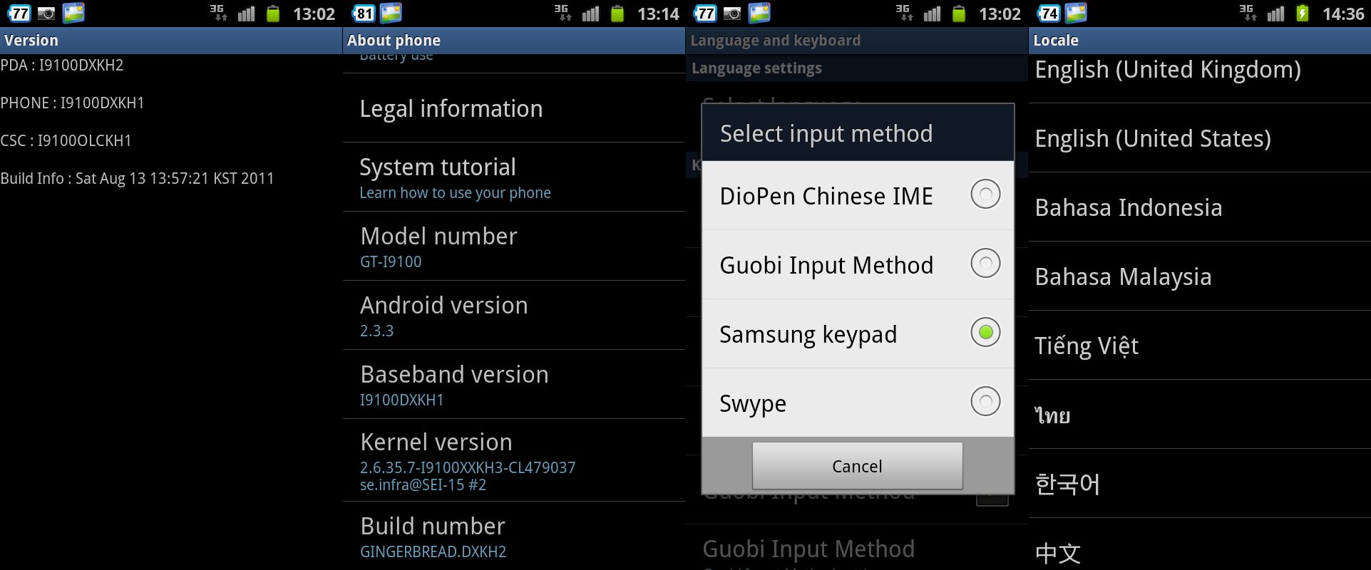

Guest skoda60 Posted September 16, 2011 Report Posted September 16, 2011 Gary, try kh3 and kh4 all failed. on kh4 I can't go any further on "f. mount -o rw,remount -t ext3 /dev/block/mmcblk1p21 /system". look like my PC evironment had problem. When I at step c: I got the $, su, nothing happen and stop as well. I still struggle and tried to figure out. I will try tonight see to see how. I try cognition S2 ROM, it worked fine for me. But I still looking for DXKH2 with Ext power menu. So I have to learn how to installing your KH4 first. SGS2 was very ruggled and never brick for me. Even I try until I facing no download mode and recover mode. Even I removed and placed back battery > I got the Big S. So I used the usb jig to bring back to download mode. I have cwm and Titanium back up and saved me many time.

Guest Lancez Posted September 17, 2011 Report Posted September 17, 2011 based on my i8000 knowledge, DXKH2 is official singapore rom, so what are the differences?
Guest skoda60 Posted September 18, 2011 Report Posted September 18, 2011 Thanks for the donation. Will work on it this week and upload a CWM version. Good, DXKH2 will be bebifit for South East Asia people because it have a all the languages and keyboard in this region. I tried KH3, KH4 on 2.3.4, no different and any good points compare to 2.3.3. All my applications were very smoothly running on Gingerbread 2.3.3 and 2.3.4.
Guest skoda60 Posted September 18, 2011 Report Posted September 18, 2011 (edited) based on my i8000 knowledge, DXKH2 is official singapore rom, so what are the differences? XWKF1 was Also Singapore ROM . But when you goto change language, It was like the european ROM. but DXKH2 you can Select either Chinese, Thai, viet, Indonesia Malay and Malaysia Malay yet it came with related language's keyboard. Also it have many csc for me to select. It was a good point of DXKH2 with Gingerbread 2.3.3 and aimed for South East Asia countries. Even samfirmware also release DXkf1 and DXKH2 at the sametime, but DXKF1 was no different to xwkf1, I was tested all this. Edited September 18, 2011 by skoda60

Guest Lancez Posted September 19, 2011 Report Posted September 19, 2011 XWKF1 was Also Singapore ROM . But when you goto change language, It was like the european ROM. but DXKH2 you can Select either Chinese, Thai, viet, Indonesia Malay and Malaysia Malay yet it came with related language's keyboard. Also it have many csc for me to select. It was a good point of DXKH2 with Gingerbread 2.3.3 and aimed for South East Asia countries. Even samfirmware also release DXkf1 and DXKH2 at the sametime, but DXKF1 was no different to xwkf1, I was tested all this. interesting, i was thinking about flashing a rom with chinese on my euro imported phone. i'm assuming singapore version is the same as euro one. how did you get it rooted, chainfire dose not have DXKH2 kernel. did you use other method?
Guest skoda60 Posted September 19, 2011 Report Posted September 19, 2011 (edited) interesting, i was thinking about flashing a rom with chinese on my euro imported phone. i'm assuming singapore version is the same as euro one. how did you get it rooted, chainfire dose not have DXKH2 kernel. did you use other method? Rooted with CF-XXKH3, used for few days without any problem. Edited September 19, 2011 by skoda60
Guest Lancez Posted September 19, 2011 Report Posted September 19, 2011 just flashed DXKH2 booted fine, but got android.process.acore force closed, caused dailer not working. have you had such problem? i flashed on top of KH3 stock,deoxed, rooted version.
Guest skoda60 Posted September 19, 2011 Report Posted September 19, 2011 (edited) just flashed DXKH2 booted fine, but got android.process.acore force closed, caused dailer not working. have you had such problem? i flashed on top of KH3 stock,deoxed, rooted version. Goto recover mode by using 3 buttoms, wide data/factory reset. reboot and your system should be goto normal. after cf-root, installed titanium backup for your applications and data. then all your application should be back. Edited September 19, 2011 by skoda60
Guest Lancez Posted September 19, 2011 Report Posted September 19, 2011 flashed CF-XXKH3 kernel despite force close. cleared cache and dalvik, factory reset. seems fine now. it can auto setup at&t's APN, cool! DXKH2 got a lot of M1,singtel and starhub's programs in there, but easy to remove tho. can switch between chinese and english on the fly! now it's time to wait for gary's work :P edit: skoda, do you have any battery mod for KH2? edit2: just saw your post, everything works fine now :D i don't use titanium backup, i just copy data/app folder onto my computer then copy it back and install them manually, seems easier for me.
