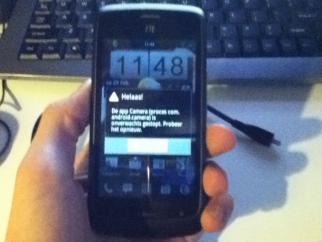

Guest matje103 Posted February 25, 2012 Report Posted February 25, 2012 (edited) These kernels are compiled from the latest 2.6.35 Kernel Source for Gingerbread ROM by ZTE Corp. Those who suffered from not working Sensors and Cameras should get them work properly with them. The upgrade process would update Wifi Firmware also which is need to get wifi work with it. Suitable for : GEN2 Blade V880, Chinese Blades (tested) V880+(not tested) Features : - Overclocking - Swap and ZRAM enabled - CPU Governors : Smartass2(Default) InteractiveX Lagfree MinMAX SavagedZen Ondemand Conservative Powersave Performance - I/O scheduler : Simple IO (Default) VR, NOOP, BFQ - RCU : Tiny RCU - 2way Incall PCM Recording NOTE : No Undervolt (Both WIFI and CPU) : they are not running good on the Blades generally. Installation : Flash with CWMRecovery (No need to Wipe) Hi Burstlam, Thanks for you kernel work, I have a dutch zte blade 5 mp version and tried your new kernel patch for Swedish Snow. The camera shows an inverted image, when I take a picture it force closes. My camera sensor information (based on my stock rom, dialercode info): ID:0x2880 Nmae:MT9P111-5.0Mp-AF I also added my dmesg. One after booting the camera and one after taking a picture and force closing. dmesg.txt dmesg2.txt Hope this helps. Edited February 25, 2012 by matje103

Guest matje103 Posted February 27, 2012 Report Posted February 27, 2012 Is there anything more I can do or test? I know lot's of people still aren't relieved from their camera issues.. I would gladly help! P.s. I noted that third party apps (such as barcode scanners and camera apps) can use the camera to make photo's. Pudding camera is able to snap photo's without force closing, the standard camera app does. Thus, all third party apps still show an inverted image.
