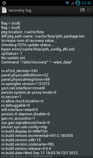

Guest Posted October 11, 2012 Report Posted October 11, 2012 (edited) Must be something else that id the device? Maybe build.prop and the file in fota folder ? Is this anything in recovery log ? Edited October 11, 2012 by Guest
Guest rickywyatt Posted October 11, 2012 Report Posted October 11, 2012 tried m8 we are going to need the update from data/fota be for up grade
