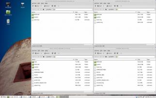

Guest komunistvb Posted March 16, 2013 Report Posted March 16, 2013 There is big deferent in zip files here is pics This miui_v4.0.4_atlas40_3.2.8.zip is not for Blade 3 i think Is there NVFlash tool for ZTE Blade 3 or if someone can make it for us in thet case there is no way to brick our devices.
