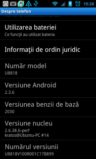

Guest Costy88031 Posted March 19, 2013 Report Posted March 19, 2013 (edited) kernel it's the same for me but my baseband is 2030 and I use a rom for U8818 This is mine Edited March 19, 2013 by Costy88031
Guest y4ss1n Posted March 19, 2013 Report Posted March 19, 2013 (edited) i also noticed i cant go above 1ghz im on atomicmod GB on baseband 2030 but the governors & schedulers work fine Edited March 19, 2013 by y4ss1n
Guest Pain_Deluxe Posted March 19, 2013 Report Posted March 19, 2013 Looks like OC dont work on 2030. Here fine 300 1229 smartass2 sio

Guest 0066ad Posted March 19, 2013 Report Posted March 19, 2013 Also 1ghz here, on atomicmod baseband 2030.

Guest george109 Posted September 29, 2013 Report Posted September 29, 2013 Wich baseband? Also 1ghz here, on atomicmod baseband 2030. Can someone resolve this? Thanks You can only overclock if your baseband 109808 with this kernel - You cannot overclock on the 2030 (ICS) baseband. If you want to overclock with this kernel, downgrade to gingerbread using an update.app to get the 109808 baseband
Guest dalyer Posted September 29, 2013 Report Posted September 29, 2013 If you want to overclock with this kernel, downgrade to gingerbread using an update.app to get the 109808 baseband You can also easily downgrade baseband using this: http://www.modaco.com/topic/361310-downgrade-upgrade-from-recovery/
