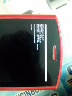

Guest d07a2010 Posted June 15, 2013 Report Posted June 15, 2013 (edited) My Mother's phone Acer liquid E Ferrari Edition is died today plz help me guys rapidly,I don't want her to know when i tried to flash Original ROM 4.005.05.AAP.GEN2_A22F_A.bin with A1_DL_Tool, it suddenly stopped on fastboot over 10 minutes and give failed message (failed fastboot) i tried to remove usb and put it again but no hope also tried this method:- 1. Pull battery in and usb cable to phone and pc Press in order and without releasing 1. < (back button) 2. Camera 3. (power) not always necessary Bootloader should appear. I think FastBoot appears but I don't know what i've to do exactly phone also charging good Sorry for my bad English Thanks in advance, Edited June 15, 2013 by d07a2010
Guest Master_T Posted June 15, 2013 Report Posted June 15, 2013 You tried to flash the wrong bin, if you have the Ferrari Edition you should use the ferrari rom: 4.002.15_EMEA-G1F_05.02.01 (For Liquid E Ferrari Edition 512MB) Since you reach bootloader, you should be able to recover it. Does Liquid Download Tool recognize the phone while it's in fastboot? If so, try to flash with the proper bin. If not you must use fastboot to flash the pieces of the ROM manually. Use this tool: https://disk.yandex.com/public/?hash=vzxWmVGP7M0FxAghxyNU1wkpp8IrltnNgnpIup0rJH8%3D to unpack the various pieces of the BIN file (the one with .img extensions), and flash them manually with fastboot. I must admit I don't know exactly the partition names to give to fastboot for flashing, someone else will have to help you with that.
Guest errmsg Posted June 15, 2013 Report Posted June 15, 2013 (edited) Here are the MTD partition names - https://github.com/roman-yepishev/android-kernel-msm/wiki/Acer-Liquid-E-Hardware Regarding unpack_acer_mergedos utility: you need to use -s option to get fastboot-flashable images, otherwise they will not work. See this thread for information on the unpacker. Edited June 15, 2013 by errmsg
