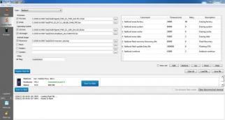

Guest karthiknr Posted December 6, 2013 Report Posted December 6, 2013 (edited) I don't know about anyone else but I'm watching with baited breath... :D Let's just be hopeful. I'm backing up using the flash tool itself but even though i unticked the shared storage/sdcard it still seems to be doing a backup of something called com.android.sharedstoragebackup and it's taking ages to complete. Almost 2 GB backed up now. Edit: I'm starting the flash now. It backed up sdcard also btw. Here's the image for the custom flash screen. I clicked the load file on the right and chose the flash.xml and arrived here. Edited December 6, 2013 by karthiknr

Guest karthiknr Posted December 6, 2013 Report Posted December 6, 2013 (edited) Too late. Ended up with this error. I will try removing the erase data part and will try again. After removing the erase data part and after registering flash file again,i went ahead and flashed. After the fastboot continue command,it boots into the recovery where a bunch of errors pop saying it cannot mount/open some folders. I chose to reboot system. It's still showing the Xolo logo. Hopefully it boots up. Edited December 6, 2013 by karthiknr

Guest karthiknr Posted December 7, 2013 Report Posted December 7, 2013 (edited) I don't know what stage you're at but would this help http://forum.xda-developers.com/showthread.php?t=1507876&page=5 post 42 Being a little optimistic,i think that would help ;) I was going through the flash.xml again and i noticed the "fastboot erase factory". I'm still not sure what that line does,the rest of the flash process seemed pretty normal for me. Also from your link,the order to make it alright would be to flash userdata,cache,boot and system and finally the recovery images again. Do we have a factory image from which i can maybe extract the userdata and the cache images(Considering the boot image is the boot.img from within the update.zip?)? And how would i go about making these images? I really can't thank you enough if this works! :D Edit: I have the boot.img and the recovery.img but i don't have the userdata.img or the cache.img or the system.img, Once i have these images i will use the following commands to make it alright: fastboot flash userdata userdata.img fastboot flash cache cache.img fastboot flash boot boot.img fastboot flash system system.img fastboot flash recovery recovery.img Correct me if i'm wrong. EDIT: It's fixed now! I did the following things to fix it: 1.Boot into the droidboot screen to enable fastboot 2.fastboot erase userdata(It will most likely give you an error) 3.fastboot erase cache 4.fastboot erase system 5.fastboot erase boot 6.fastboot flash boot boot.img(This is the boot.img from within the update.zip) 7.fastboot flash update update.zip After this,it rebooted by itself. There was a flash of the Xolo logo and then the screen went blank. Adb access was there at this point. To make sure i did adb ls /system and all the folders were there. So now because the update.zip was the 299MB one,i used the HDMI method to do an OTA update and it's all sorted now. I will check the folders again to see if any memory is missing or has ocupied extra space. Thanks a lot guys! BlueMoonRising,that link you posted had the right flash/erase order,like i said,can't thank you enough! :D Edited December 7, 2013 by karthiknr
