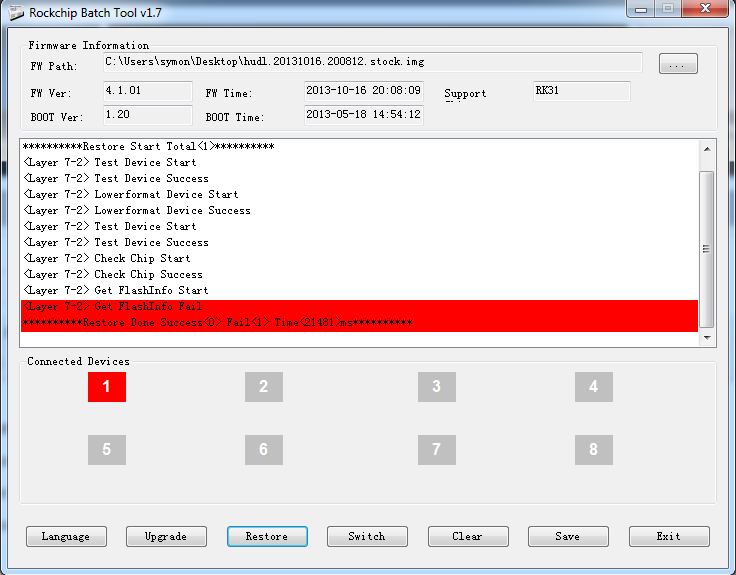

Guest Sborny Posted December 3, 2013 Report Posted December 3, 2013 Hi, I have tried to flash various Roms and keep getting a Get FlashInfo Failure. It was updated as soon as I bought it and then rooted Nothing else has been done to it. Does any one have any ideas why this might happen, more importantly, how to get round it as I am now in the 1.3 update loop. I have attached a screen shot. Thanks in advance Symon.
Guest Mr Lawrence Posted December 3, 2013 Report Posted December 3, 2013 Hi it looks like you are not in "Flashing Mode" on the tablet or you dont have the driver`s installed the attached devices box 1 should be green when everything is installed and ready to flash to get the hudl into flashing mode do this as per Paul`s Post regarding RKtools and stock rom "connect your device, press the reset pin while holding volume up and install drivers if prompted."if you have downloaded the required files from that post and you have checked other things like usb ports/cables etc and there all ok then the box should turn green and you can flash away. Hope this helps
Guest Sborny Posted December 3, 2013 Report Posted December 3, 2013 Hi, Thanks for posting. I do get the green box. The screen shot is from after I have connected the device, pressed the volume up and reset buttons which then gives me the green light. I then click the restore button which starts the process. Then after about 30 seconds I get the error in the screen shot. Hope that clears things up. Cheers.
Guest Mr Lawrence Posted December 4, 2013 Report Posted December 4, 2013 Ok dont know if you have managed to sort it yet i have not been able to replicate your issue on my hudl.The only other advice i can give is are you running rktools as Admin? Try unzipping the image file straight to the desktop (i had an issue with a Ainol Auroa that would not flash unless the image was on the desktop) Try on another laptop/pc if poss and finally try downloading one of the images again it could be that something happened to them i would try pauls stock image as i have used that several times to get me out of trouble! Hope you get to the bottom of it Cheers

Guest Posted December 5, 2013 Report Posted December 5, 2013 Sborny just thought, have you checked the downloaded image file hash value?
