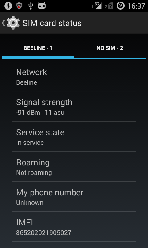

Guest debian2 Posted October 30, 2014 Report Posted October 30, 2014 How to remove 2 SIM settings from my v811's firmware?
Guest KonstaT Posted October 30, 2014 Report Posted October 30, 2014 How to remove 2 SIM settings from my v811's firmware? Isn't that a dual-SIM device? Why would you want to remove it?
Guest debian2 Posted October 30, 2014 Report Posted October 30, 2014 Isn't that a dual-SIM device? Why would you want to remove it? v811 is single-SIM. Why? Because it is excess. Many garbage settings for SIM-2
Guest KonstaT Posted October 30, 2014 Report Posted October 30, 2014 v811 is single-SIM. Why? Because it is excess. Many garbage settings for SIM-2 What is the exact make/model of your device and where (country) it was purchased? Have you installed any official ZTE firmware packages to your device? Post a screenshot of 'Kis 3 Hardware Info' app too. Dual-SIM features are enabled on devices with ro.boot.hwversion=wmfA.6 and so far that has only been reported on V811W's.
Guest debian2 Posted October 30, 2014 Report Posted October 30, 2014 What is the exact make/model of your device and where (country) it was purchased? Have you installed any official ZTE firmware packages to your device? Post a screenshot of 'Kis 3 Hardware Info' app too. Dual-SIM features are enabled on devices with ro.boot.hwversion=wmfA.6 and so far that has only been reported on V811W's. My phone is «Билайн Смарт 2» («Beeline Smart 2»). Purchased in Russia. I firmwared Android_4.4_EU_P821E10V1.0.0B06_DL with Open C update tool. My build.prop: # begin build properties # autogenerated by buildinfo.sh ro.build.id=KTU84Q ro.build.display.id=cm_kis3-userdebug 4.4.4 KTU84Q dc854dd8a2 test-keys ro.build.version.incremental=dc854dd8a2 ro.build.version.sdk=19 ro.build.version.codename=REL ro.build.version.release=4.4.4 ro.build.date=Wed Oct 29 09:53:58 EET 2014 ro.build.date.utc=1414569238 ro.build.type=userdebug ro.build.user=tuomas ro.build.host=hope ro.build.tags=test-keys ro.product.brand=ZTE ro.product.name=cm_kis3 ro.product.board=MSM8610 ro.product.cpu.abi=armeabi-v7a ro.product.cpu.abi2=armeabi ro.product.manufacturer=ZTE ro.product.locale.language=en ro.product.locale.region=US ro.wifi.channels= ro.board.platform=msm8610 # ro.build.product is obsolete; use ro.product.device ro.build.product=kis3 ro.product.model=Kis 3 ro.product.device=kis3 # Do not try to parse ro.build.description or .fingerprint ro.build.description=msm8610-user 4.4.2 KOT49H eng.root.20140509.130110 release-keys ro.build.fingerprint=ZTE/ZTE-P821E10/ZTE-P821E10:4.4.2/KOT49H/eng.root.20140509.130110:user/release-keys ro.build.characteristics=default ro.cm.device=kis3 # end build properties # # from device/zte/kis3/system.prop # # Audio ro.qc.sdk.audio.fluencetype=none persist.audio.fluence.voicecall=true persist.audio.fluence.voicerec=false persist.audio.fluence.speaker=true use.voice.path.for.pcm.voip=true audio.offload.buffer.size.kb=32 audio.offload.gapless.enabled=true audio.offload.multiple.enabled=false audio.offload.pcm.enable=false av.offload.enable=false av.streaming.offload.enable=false tunnel.audio.encode=false # Display ro.sf.lcd_density=240 ro.opengles.version=196608 debug.composition.type=dyn debug.hwc.dynThreshold=1.5 debug.sf.fb_always_on=1 # GPS ro.qc.sdk.izat.premium_enabled=0 ro.qc.sdk.izat.service_mask=0x0 persist.gps.qc_nlp_in_use=0 persist.loc.nlp_name=com.qualcomm.services.location ro.gps.agps_provider=1 # Media media.stagefright.enable-player=true media.stagefright.enable-http=true media.stagefright.enable-aac=true media.stagefright.enable-qcp=true media.stagefright.enable-fma2dp=true media.stagefright.enable-scan=true mmp.enable.3g2=true media.aac_51_output_enabled=true mm.enable.qcom_parser=37491 vidc.debug.level=1 # Memory ro.config.low_ram=true ro.ksm.default=1 # Qualcomm ro.vendor.extension_library=/system/vendor/lib/libqc-opt.so ro.qualcomm.cabl=0 # Recovery ro.cwm.enable_key_repeat=true # Telephony rild.libpath=/vendor/lib/libril-qc-qmi-1.so rild.libargs=-d /dev/smd0 persist.rild.nitz_plmn= persist.rild.nitz_long_ons_0= persist.rild.nitz_long_ons_1= persist.rild.nitz_long_ons_2= persist.rild.nitz_long_ons_3= persist.rild.nitz_short_ons_0= persist.rild.nitz_short_ons_1= persist.rild.nitz_short_ons_2= persist.rild.nitz_short_ons_3= ril.subscription.types=NV,RUIM DEVICE_PROVISIONED=1 persist.radio.msgtunnel.start=false ro.telephony.default_network=0 telephony.lteOnCdmaDevice=1 persist.data_netmgrd_mtu=1358 persist.radio.apm_sim_not_pwdn=0 ro.telephony.call_ring.multiple=false # Time services persist.timed.enable=true # Wifi wifi.interface=wlan0 # # ADDITIONAL_BUILD_PROPERTIES # ro.rommanager.developerid=cyanogenmod ro.com.google.clientidbase=android-zte keyguard.no_require_sim=true ro.url.legal=http://www.google.com/intl/%s/mobile/android/basic/phone-legal.html ro.url.legal.android_privacy=http://www.google.com/intl/%s/mobile/android/basic/privacy.html ro.com.android.wifi-watchlist=GoogleGuest ro.setupwizard.enterprise_mode=1 ro.com.android.dateformat=MM-dd-yyyy ro.com.android.dataroaming=false ro.build.selinux=1 persist.sys.dalvik.multithread=false persist.sys.dun.override=0 persist.sys.root_access=1 ro.cm.version=11-20141029-UNOFFICIAL-KonstaKANG-kis3 ro.cm.releasetype=UNOFFICIAL ro.modversion=11-20141029-UNOFFICIAL-KonstaKANG-kis3 ro.cmlegal.url=http://www.cyanogenmod.org/docs/privacy persist.sys.recovery_update=false ro.cm.display.version=11-20141029-UNOFFICIAL-KonstaKANG-kis3 ro.config.notification_sound=Argon.ogg ro.config.alarm_alert=Hassium.ogg ro.config.ringtone=Orion.ogg ro.carrier=unknown dalvik.vm.heapstartsize=5m dalvik.vm.heapgrowthlimit=48m dalvik.vm.heapsize=128m dalvik.vm.heaptargetutilization=0.75 dalvik.vm.heapminfree=512k dalvik.vm.heapmaxfree=2m persist.sys.dalvik.vm.lib=libdvm.so dalvik.vm.lockprof.threshold=500 net.bt.name=Android dalvik.vm.stack-trace-file=/data/anr/traces.txt
Guest KonstaT Posted October 30, 2014 Report Posted October 30, 2014 My phone is «Билайн Смарт 2» («Beeline Smart 2»). Purchased in Russia. I firmwared Android_4.4_EU_P821E10V1.0.0B06_DL with Open C update tool. So then your device is Билайн Смарт 2 (Beeline Smart 2), not V811 like you were saying. Have you installed any other ZTE firmware after using the windows flasher? Because for some reason people on Russian forums have been instructed to install V811W (dual-SIM) firmware on their device?!? That would mean you'd also have a bootloader from dual-SIM firmware which passes the hwversion value. That is build.prop from my CyanogenMod build so that's no use here. I already tried asking several times but no one answered. I guess that happens when you're only inside your 4PDA bubble. Could you (or someone else with Beeline Smart2) post a screenshot of hardware info app to the appropriate thread? There's one notable difference in Beeline Smart2's that isn't addressed yet. I'd need some intelligent way to identify Beeline Smart2's first (ro.boot.hwversion possibly?). Anyone? Beeline Smart2 has a smaller capacity battery (1200mAh vs 1400mAh) and it should use a different kernel battery monitoring driver. This would be easily resolved if there was some way to identify Beeline Smart2's (ro.boot.hwversion possibly?). I still need the above information from 'untouched' Beeline Smart 2 (no other ZTE firmware updates than from Beeline). Sorry, yours is no good anymore. I even already wrote the code to use the correct battery data driver on Beeline Smart 2's, I'd only need to know the hwversion...
Guest debian2 Posted October 30, 2014 Report Posted October 30, 2014 So then your device is Билайн Смарт 2 (Beeline Smart 2), not V811 like you were saying. Have you installed any other ZTE firmware after using the windows flasher? Because for some reason people on Russian forums have been instructed to install V811W (dual-SIM) firmware on their device?!? That would mean you'd also have a bootloader from dual-SIM firmware which passes the hwversion value. That is build.prop from my CyanogenMod build so that's no use here. I already tried asking several times but no one answered. I guess that happens when you're only inside your 4PDA bubble. I still need the above information from 'untouched' Beeline Smart 2 (no other ZTE firmware updates than from Beeline). Sorry, yours is no good anymore. I even already wrote the code to use the correct battery data driver on Beeline Smart 2's, I'd only need to know the hwversion... OK. All of these from Beeline Smart 2 firmware 0.3 build.prop # begin build properties # autogenerated by buildinfo.sh ro.build.id=KOT49H ro.build.display.id=Beeline Smart2 V0.3 ro.build.inner.version=BEE_RU_P821E10V1.0.0B04 ro.sdupdate.check.info=P821E10 ro.build.secureversionid= ro.build.version.incremental=eng.root.20140531.014004 ro.build.version.sdk=19 ro.build.version.codename=REL ro.build.version.release=4.4.2 ro.build.date=Sat May 31 01:41:17 CST 2014 ro.build.date.utc=1401471677 ro.build.type=user ro.build.user=root ro.build.host=SCL_XA242_087 ro.build.tags=release-keys ro.product.model=Beeline Smart2 ro.product.brand=ZTE ro.product.name=ZTE-V811 ro.product.device=ZTE-V811 ro.product.board=MSM8610 ro.product.cpu.abi=armeabi-v7a ro.product.cpu.abi2=armeabi ro.product.manufacturer=ZTE ro.product.locale.language=ru ro.product.locale.region=RU ro.wifi.channels= ro.board.platform=msm8610 # ro.build.product is obsolete; use ro.product.device ro.build.product=ZTE-V811 # Do not try to parse ro.build.description or .fingerprint ro.build.description=msm8610-user 4.4.2 KOT49H eng.root.20140531.014004 release-keys ro.build.fingerprint=ZTE/ZTE-V811/ZTE-V811:4.4.2/KOT49H/eng.root.20140531.014004:user/release-keys ro.build.characteristics=default # end build properties # # from device/qcom/msm8610/system.prop # # # system.prop for msm8610 # # Use reference RIL for initial bringup #rild.libpath=/system/lib/libreference-ril.so rild.libpath=/vendor/lib/libril-qc-qmi-1.so rild.libargs=-d /dev/smd0 persist.rild.nitz_plmn= persist.rild.nitz_long_ons_0= persist.rild.nitz_long_ons_1= persist.rild.nitz_long_ons_2= persist.rild.nitz_long_ons_3= persist.rild.nitz_short_ons_0= persist.rild.nitz_short_ons_1= persist.rild.nitz_short_ons_2= persist.rild.nitz_short_ons_3= ril.subscription.types=NV,RUIM DEVICE_PROVISIONED=1 persist.radio.msgtunnel.start=false persist.radio.atfwd.start=false # Start in cdma mode ro.telephony.default_network=3 #ZTE shihongliang 20140315 reduce UNSOL_RESPONSE_VOICE_NETWORK_STATE_CHANGED message persist.radio.add_power_save=1 #ZTE_MODIFY by shihongliang enable fastdormancy persist.env.fastdorm.enabled=true # # system props for the cne module # persist.cne.feature=1 # Skip /sys/power/wait_for_fb_* nodes and # force FB to be always on debug.sf.fb_always_on=1 debug.composition.type=dyn debug.gralloc.map_fb_memory=0 debug.hwc.dynThreshold=1.5 dalvik.vm.heapsize=36m dev.pm.dyn_samplingrate=1 ro.hdmi.enable=true #system props for the MM modules media.stagefright.enable-player=true media.stagefright.enable-http=true media.stagefright.enable-aac=true media.stagefright.enable-qcp=true media.stagefright.enable-fma2dp=true media.stagefright.enable-scan=true mmp.enable.3g2=true media.aac_51_output_enabled=true #37491 is decimal sum of supported codecs in AAL #codecs: AVI AC3 ASF AAC QCP DTS 3G2 MP2TS mm.enable.qcom_parser=37491 # VIDC: debug_levels # 1:ERROR 2:HIGH 4:LOW 0:NOlogs 7:AllLogs vidc.debug.level=1 # # system props for widevine # persist.gralloc.cp.level3=1 # add by ZTE lizhao for widevine 20120517 drm.service.enabled=true # add by ZTE lizhao for widevine 20120517 # # system props for the data modules # ro.use_data_netmgrd=true #system props for time-services persist.timed.enable=true #ZTEBSP lichuangchuang add for audio start. 20130922 # System props for audio persist.audio.fluence.mode=endfire persist.audio.vr.enable=false persist.audio.lowlatency.rec=false persist.audio.handset.mic=analog # System prop to select audio resampler quality af.resampler.quality=255 # System prop to select MPQAudioPlayer by default on mpq8064 mpq.audio.decode=true #ZTEBSP lichuangchuang add for audio end. 20130922 # # system prop for opengles version # # 196608 is decimal for 0x30000 to report version 3 ro.opengles.version=196608 # # System props for telephony # System prop to turn on CdmaLTEPhone always telephony.lteOnCdmaDevice=1 # simulate sdcard on /data/media # persist.fuse_sdcard=true # #snapdragon value add features # ro.qc.sdk.audio.ssr=false ##fluencetype can be "fluence" or "fluencepro" or "none" ro.qc.sdk.audio.fluencetype=none persist.audio.fluence.voicecall=true persist.audio.fluence.voicerec=false persist.audio.fluence.speaker=true # Reduce Background apps limit ro.sys.fw.bg_apps_limit=20 # System property for cabl #zte modify 20130904 ro.qualcomm.cabl=0 # system prop for NFC DT ro.nfc.port=I2C #liangrh add GMS clientid ro.com.google.clientidbase= android-zte ro.com.google.clientidbase.yt= android-zte ro.com.google.clientidbase.gmm= android-zte ro.com.google.clientidbase.am = android-vimpelcom-ru ro.com.google.clientidbase.ms = android-zte # #DASH video streaming #Specify max allowed resolution/bandwidth for representations #Set allowed avsync window during playback # persist.dash.max.rep.resolution=1280*720 persist.dash.max.rep.bandwidth=4000000 persist.dash.avsync.window.msec=100 tunnel.audio.encode = false #use VERY_HIGH_QUALITY for audio resampler af.resampler.quality=4 ro.config.low_ram=true #Buffer size in kbytes for compress offload playback audio.offload.buffer.size.kb=32 #8x10 does not support tunnel av playback #this prop should be set to false all the time av.offload.enable=false #enable voice path for PCM VoIP by default use.voice.path.for.pcm.voip=true # #System property for FM transmitter # ro.fm.transmitter=false #enable dsp gapless mode by default audio.offload.gapless.enabled=true # ZTE_MODIFY ,zhangshuzu,2014.04.11, System props for streaming ua profile, begin ro.streaming.ua.prof = http://zte.com.cn/mobile/uaprof/Beeline_Smart2.xml # ZTE_MODIFY ,zhangshuzu,2014.04.11, System props for streaming ua profile, end # zte_modify,sonlgifeng,for 8x10 default timezone,2013.12.30 begin persist.sys.timezone=Europe/Moscow # zte_modify,sonlgifeng,for 8x10 default timezone,2013.12.30 end # ZTE_MODIFY,liyanfang,for 8x10 default MTU size,2014.01.15 begin # set default mtu to 1358 persist.data_netmgrd_mtu=1358 # ZTE_MODIFY,liyanfang,for 8x10 default MTU size,2014.01.15 end # zte_modify,chenshaohua,for 8x10 default memory optimize,2014.03.11 begin persist.sys.memoryclean.enable=1 persist.sys.memoryclean.thres=10 # zte_modify,chenshaohua,for 8x10 default memory optimize,2014.03.11 end # ZTE_MODIFY caoyaobin disable JIT dalvik.vm.jit.codecachesize=0 # # ADDITIONAL_BUILD_PROPERTIES # persist.sys.logkit.ctrlcode=0 keyguard.no_require_sim=true ro.com.android.dataroaming=false ro.com.android.dateformat=MM-dd-yyyy ro.config.ringtone=Ring_Synth_04.ogg ro.config.notification_sound=pixiedust.ogg ro.carrier=unknown ro.config.alarm_alert=Alarm_Classic.ogg ro.vendor.extension_library=/vendor/lib/libqc-opt.so persist.radio.apm_sim_not_pwdn=0 ro.config.low_ram=true dalvik.vm.heapstartsize=5m dalvik.vm.heapgrowthlimit=48m dalvik.vm.heapsize=128m dalvik.vm.heaptargetutilization=0.75 dalvik.vm.heapminfree=512k dalvik.vm.heapmaxfree=2m ro.setupwizard.mode=OPTIONAL ro.com.google.gmsversion=4.4_r3 persist.sys.dalvik.vm.lib=libdvm.so net.bt.name=Android dalvik.vm.stack-trace-file=/data/anr/traces.txt ro.qc.sdk.izat.premium_enabled=1 ro.qc.sdk.izat.service_mask=0x5 persist.gps.qc_nlp_in_use=1 persist.loc.nlp_name=com.qualcomm.services.location ro.gps.agps_provider=1 default.prop # # ADDITIONAL_DEFAULT_PROPERTIES # ro.secure=1 ro.adb.secure=1 ro.allow.mock.location=0 ro.debuggable=0 persist.sys.strict_op_enable=false persist.sys.whitelist=/system/etc/whitelist_appops.xml
Guest KonstaT Posted October 30, 2014 Report Posted October 30, 2014 OK. All of these from Beeline Smart 2 firmware 0.3 Sorry, I guess I didn't make myself quite clear. I need that information from an 'untouched' Beeline Smart2 (no ZTE updates what so ever). Restoring CWM backup of Beeline firmware is not enough. It does not restore your device's bootloaders or modem firmware. These will always remain the same as the last official ZTE firmware update you've installed (or the stock firmware your device shipped with). Take your favorite zip tool and look inside an official ZTE update.zip, then look inside CyanogenMod ROM package. You'll notice some files missing right from the start. These are the bootloader/modem firmware files. As far as I know there's official Beeline update.zip thus no way to restore/flash Beeline bootloader/modem. Also you didn't answer if you've installed V811 (dual-SIM) firmware to your device? That might explain the wmfA.6 and in that case flashing Kis 3 (single-SIM) firmware might make a difference. It's of course also possible that all Beeline Smart2's are identified as wmfA.6 which wouldn't be ideal in terms what I had planned. :( I'd still need the data from few devices to verify.
