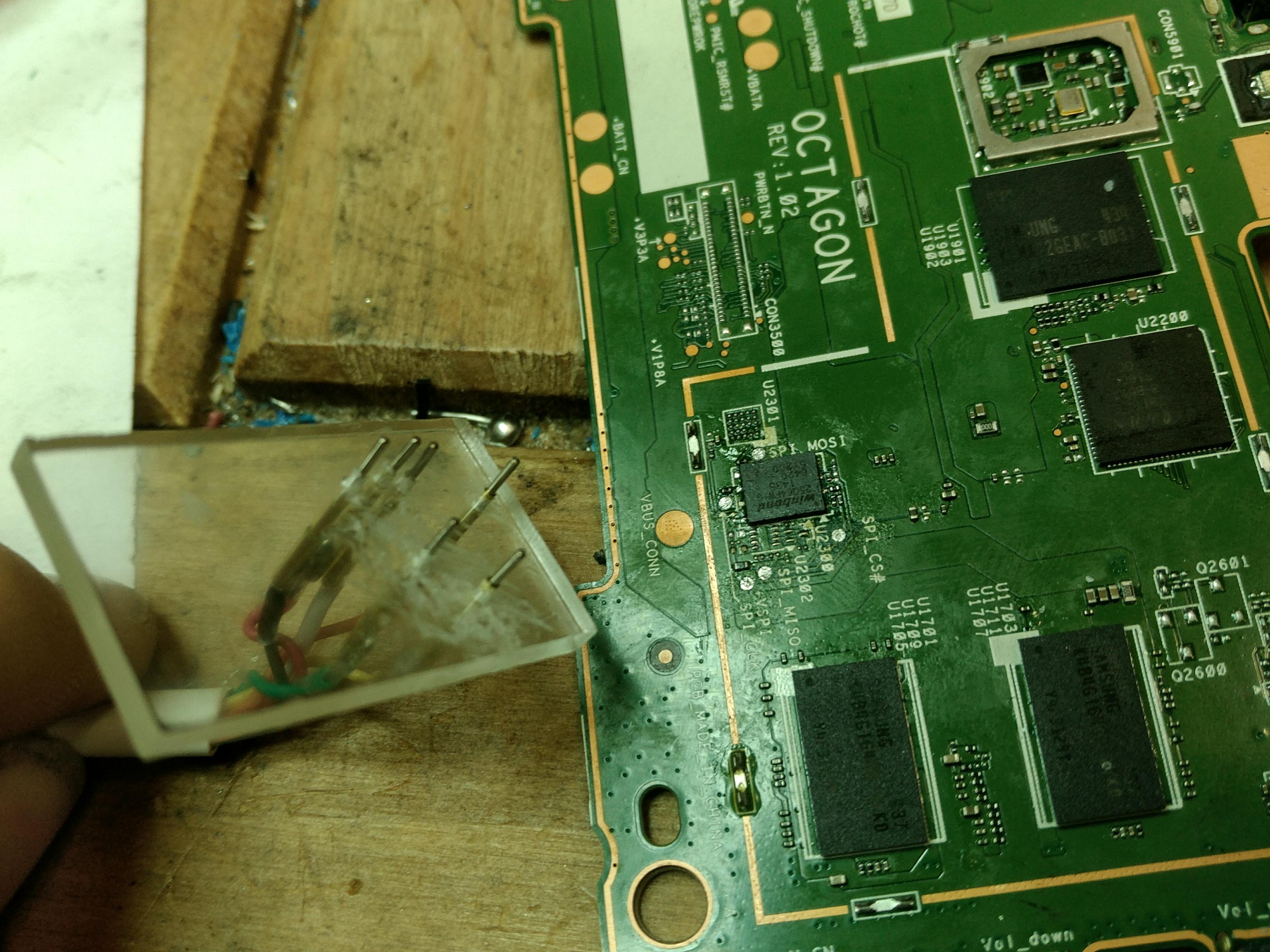

Guest dazmatic Posted April 24, 2019 Report Posted April 24, 2019 DIY Pogo pin programmer clip. Handy having a laser engraver!
