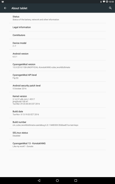

Guest KonstaT Posted November 8, 2016 Report Share Posted November 8, 2016 (edited) Here's an early taste of Marshmallow for Cube iWork8 Ultimate (I1-T/I1-TD/I1-TWB/I1-TC) and iWork8 Air (I1-TF). It is unofficial and unsupported by the CyanogenMod team. It's for advanced users only. This is an early alpha build and it's not recommended for daily use (see issues below). Do not mirror my builds! Please post a link to this page instead. cm-13.0-20161108-UNOFFICIAL-KonstaKANG-cube_iwork8ultimate.ziphttp://konstakang.com/devices/cube_iwork8ultimate/CM13 Google apps:The Open Gapps Project Working: Audio (playback/input/routing/headphones/etc) Bluetooth Camera Hardware acceleration and OpenGL rendering Hardware video decoding & encoding HDMI Houdini Network/wifi location SD cards Sensors Touchscreen/multi-touch USB OTG (storage, mouse, keyboard) USB storage (MTP and PTP) & adb USB-tethering Wifi Wifi-tethering Not working: ??? Issues: Device doesn't enter deep sleep mode - expect increased battery drain! SELinux is disabled (needs kernel update which is not possible without kernel source) No app battery usage stats under 'Settings -> Battery' (needs kernel update which is not possible without kernel source) Audio not routed through HDMI and more... Sources: CM-CHT Kernel (stock kernel) Thanks: CyanogenMod team & everyone who's been working on CM13 Like my work? Edited November 10, 2018 by KonstaT Link to comment Share on other sites More sharing options...
Guest KonstaT Posted November 8, 2016 Report Share Posted November 8, 2016 (edited) Merged commits not mentioned in the changelog. 8.11. changelog: initial release Edited November 8, 2016 by KonstaT Link to comment Share on other sites More sharing options...
Guest KonstaT Posted November 8, 2016 Report Share Posted November 8, 2016 (edited) How to install: boot into TWRP recovery backup -> backup (create a nandroid backup of your current ROM) wipe -> advanced wipe -> wipe /system wipe -> factory reset install cm-13.0-xxxxxxxx-KonstaKANG-cube_iwork8ultimate.zip (install I1-TD/I1-TWB/I1-TC/I1-TF/I1-TFB patch if necessary - see FAQ below) install open_gapps-x86-6.0-pico-xxxxxxxx.zip reboot system FAQ: Q: I can't find developer options and performance settings, why?A: Settings -> About tablet -> Click 'Build number' several times Q: I don't have reboot options in power menu, why?A: Settings -> Developer options -> Advanced reboot Q: I have no root, why? What is that hashtag on my status bar?A: Settings -> Developer options -> Root access. Root management is now integrated as part of CM's Privacy Guard and you can manage per app permissions under Settings -> Privacy -> Privacy Guard. You'll have a persistent notification in the status bar when you're running an app that uses root permissions. Q: I have iWork8 Ultimate I1-TD/I1-TWB/I1-TC with different touchscreen hardware. What should I do?A: Download patch below suitable for your device and install it in TWRP. cm-13.0-20161108-cube_iwork8ultimate-I1-TD.ziphttp://konstakang.com/devices/cube_iwork8ultimate/CM13 cm-13.0-20161108-cube_iwork8ultimate-I1-TWB.ziphttp://konstakang.com/devices/cube_iwork8ultimate/CM13 cm-13.0-20161108-cube_iwork8ultimate-I1-TC.ziphttp://konstakang.com/devices/cube_iwork8ultimate/CM13 Q: I have iWork8 Air I1-TF/I1-TFB with different display hardware. What should I do?A: Download patch below and install it in TWRP. cm-13.0-20161108-cube_iwork8ultimate-I1-TF.ziphttp://konstakang.com/devices/cube_iwork8ultimate/CM13 cm-13.0-20161108-cube_iwork8ultimate-I1-TF-20161108.ziphttp://konstakang.com/devices/cube_iwork8ultimate/CM13 cm-13.0-20161108-cube_iwork8ultimate-I1-TFB.ziphttp://konstakang.com/devices/cube_iwork8ultimate/CM13 Edited February 12, 2017 by KonstaT Link to comment Share on other sites More sharing options...
