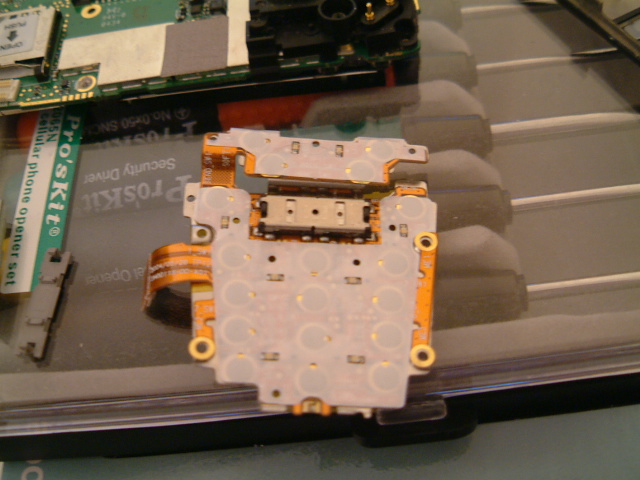

Guest holr Posted February 15, 2005 Report Posted February 15, 2005 (edited) Hi again! Sorry for not replying sooner, am a bit ill at the moment! Opened up the c500 and took a look at the numbers on the back of the lcd, see the pics for more info :( Any news on your front? Have you sent it to dubai yet? :lol: *edit* added some photos of the c500's joystick Edited February 15, 2005 by holr
Guest radiator Posted February 15, 2005 Report Posted February 15, 2005 (edited) Hi again! Sorry for not replying sooner, am a bit ill at the moment! Opened up the c500 and took a look at the numbers on the back of the lcd, see the pics for more info :( Any news on your front? Have you sent it to dubai yet? :lol: *edit* added some photos of the c500's joystick <{POST_SNAPBACK}> Hey holr, thanks for replying (despite being ill - there's a nasty cold/flu virus going round at the moment, luckily I havn't caught it (yet!)) By the looks if it, the C500 LCD is identical to the SP3i one (apart from the one digit difference in the 'part number'). Havn't heard anything back from i-Mate yet (email asking for a quote (including shipping + repair) - that was just under a week ago, so I think I'll email them again tomorrow. In the meantime, I might have found a C500 to buy, and simply swap the LCD over...just gotta decide whether to wait for a repair quote or just go ahead with it. One other question - how have you detached the keypad from both the PCB and the phone casing? On my SP3i it looks like it needs de-soldering...does it just pull off? I really need to look at mine and see if I can figure out why the keypad light has stopped working. Once again, thanks for the pics, they really help! **edit** Just figured out how to detach the keypad from the PCB (didn't realise it was a plug/socket!), and after reconnecting and fiddling, the backlight works, but only when the ribbon cable is held in a certain position :?: But still, how does the keypad detach from the phone case? Sorry, this thread is going way off track from the original "where can I find replacement parts" theme...keep forgetting to ask, how's your search for an SP3i joystick going? :D Edited February 15, 2005 by radiator
Guest holr Posted February 16, 2005 Report Posted February 16, 2005 Hi again! With regard detaching the keypad from the phone case (not sure if you mean the part I photographed, the bit with the joystick mount on it or the actual keypad, with the numbers and letters on it) I had to unscrew 4 tiny screws from the back of the part I photographed earler, then just lifted it off. The keypad buttons seem easy enough to remove also, they all appear to be backed (i.e. stuck) on a rubber pad which I have trouble keeping in when im putting the phone back together! With the original topic, I haven't found any spare joystick parts so far unfortunately, so I can't carry out the modification. Tried ebay, but they are only selling sp3is (no spares seem to come up yet :lol: ), not just the parts. Contacted htc in taiwan using the email addresses from their website, but they havent replied to me yet. Typical, quick to sell you something, take forever to get back to you! If you are able to get the joypad (with the joystick mount on it) off of your sp3i, could you try to photo it for me? Im just curious to see how the soldering is on the sp3i joystick mount, and if it is at all similar to the c500... thanks! holr
Guest radiator Posted February 16, 2005 Report Posted February 16, 2005 Righty... The back of the SP3i keypad looks like this; The red blobs indicate where the 2 screws fit. Now, all of the silver parts look like they're attached to the main part of the housing, and I can't remove them. However, the section highlighted in purple does fold back on itself (after removing the screws, and the top (silver) part of the joystick); The grey 'block' is where the top (visible) part of the joystick attaches. And another image; Unfortunately, they're the best pictures I can take at the moment, but I can tell you that the actual joystick 'switch' looks to be around 6 or 7mm in width and length. It has 3 solder connections either side (that connect to the flimsy PCB-like wotnot) - I'm guessing it's these connections that provide the 'data' (which would make sense - each of the 6 would be 'up', 'down', 'left', 'right', 'click' and 'ground'). There are another 6 connections (3 on top, 3 on bottom) that are a bit wider, but to me they just look as though they hold the joystick in place (although I may be wrong)... As I havn't yet heard back from i-Mate, I'm sorting out a deal with another MoDaCo member to purchase their SP3i...which will mean I'll have a spare keypad going (providing I actually buy their SP3i). I'll keep you updated though. :lol:
Guest holr Posted February 17, 2005 Report Posted February 17, 2005 Hey thanks a lot for the pics, radiator! They help me out a lot. Looks like it would be a fiddle to try to remount the joystick from the sp3i to the c500, but perhaps possible. What is encouraging though is the little ribbon cable coming off the main keypad (as in the first picture you can see it in the top left) this looks, at a glance, identical to the spv c500's... maybe it could be a simple case of just swaping out the whole keypad area and seeing how the keys.... we will see! If your deal does go through for the sp3i and you end up with some spare parts you'd like to sell on, you know where to come :lol: Good luck! And keep me posted!

Guest holr Posted February 17, 2005 Report Posted February 17, 2005 to be honest i havent been able to do any testing, ive been hopeful of getting some parts to play with first. Theres a thought though, perhaps the stick from a t610 or something may work... I feel now however after seeing your picture of the keypad backing with the wire hanging off it (to connect it to the mainboard) that this looks very much like the c500. I guess the easiest thing to try before doing any botch soldering work is to get this complete part from a sp3i, plug it into my c500 and see if it comes on...
