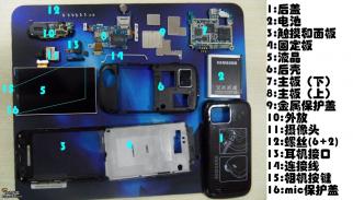

Guest cpinilla1986 Posted April 4, 2010 Report Posted April 4, 2010 I cant Find a tutorial on how to replace the faceplate, not the screen just the housing, do I have to go through the whole dissassembling process? thank you.

Guest mecgyver Posted May 3, 2010 Report Posted May 3, 2010 Hi all, Thank you very much for this usefull photo guide. I succesfully disassembled my i8000 to replace a broken LCD and, most important, reassembled everything back! The problem is that I now have a really poor quality of the image. colours are faded and several and an horizontal pattern light-dark makes me unhappy. New display is original Samsung, and was produced the same day of the original one (!) Do anyone know if there is a specific tool to fix what seems a calibration problem? I tried lcdtest.exe found under windows but there are no option to modify settings. Thanks in advance for any help will come!

Guest pitymonkey Posted August 15, 2010 Report Posted August 15, 2010 My I8000 has dust under the screen. Is there a better way to remove this without disassemble all the phone?
Guest Pawel81 Posted August 21, 2010 Report Posted August 21, 2010 No, You must disassembly the entire phone. Few minutes ago I ended cleaning screen. I put soft glue in the slit so no more dust, no more disassembling.

Guest starnumberone Posted March 13, 2011 Report Posted March 13, 2011 800Mhz CPU Final working assembly Excellent step by step manual . Cleaned the dust from behind my screen. recommend using a small sponge ( I used one that my girl applyes a make up with ) THANKS

Guest lukk555 Posted September 10, 2012 Report Posted September 10, 2012 I've just managed to clean the dust under my display with this tutorial, thanks! It is a little bit more complicated than it looks, there is some sticky tape under the main board and it gives you an impression like it's just about to crash. Tricky part is the cleaning itself too, to remove all the dust and not to leave some small hairs or leftovers of the cloth. Anyway, following the pictures from the first post seems to be a better idea than using "disassembly/assembly" part of service manual. I was trying to use it before but I just got stuck at some step and wasn't able to continue.
