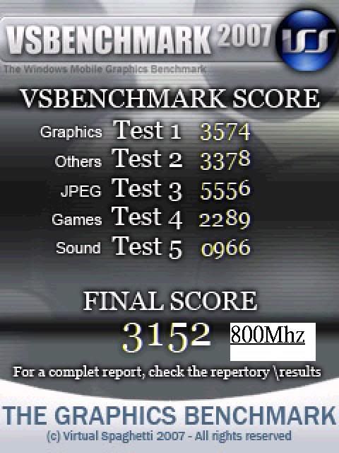

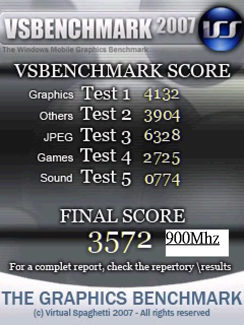

Guest taril Posted November 29, 2009 Report Posted November 29, 2009 (edited) Coreplayer 480p video benchmark: Edited November 29, 2009 by taril

Guest gt100 Posted November 30, 2009 Report Posted November 30, 2009 Coreplayer 480p video benchmark: Wow! Fantastic increase of preformance! What about battery life at 1GHz?
