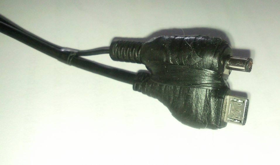

Guest XeOS Posted January 28, 2010 Report Posted January 28, 2010 hmmmm I prolly stupid :-). Does you mean you opened jack connector and cut one of the soldered cables ends inside connector so only one pin is used instead of two. Than I will cut rest of cable at some point so finall I will have piece of cutted cable ending by jack with one of pins unsoldered. Is that what u mean ? Look at the previous post and click on the link
Guest mmstudio Posted January 28, 2010 Report Posted January 28, 2010 XeOS: I looked already before but the picture doesnt tell me anything... I still dont know...
Guest phj Posted January 28, 2010 Report Posted January 28, 2010 XeOS: I looked already before but the picture doesnt tell me anything... I still dont know... Please compare the jack on the picture with your earpiece jack. You will see that the jack in the picture is shorten - this is because it is cutted . So you doesn't need to open your Omnia, just make a special jack connector...
Guest mmstudio Posted January 28, 2010 Report Posted January 28, 2010 (edited) Please compare the jack on the picture with your earpiece jack. You will see that the jack in the picture is shorten - this is because it is cutted . So you doesn't need to open your Omnia, just make a special jack connector... I compared already before - all I can see its not only shoter jack - its absolutely different connector type than connector of my earphones - I have classic earphone standard stereo minijack on your picture is absolutely different connector type - it looks like connector from my 12vdc power adaptors for travelling .... Do we talking both about omnia 2 i8000 ? EDIT: Im getting there :-) .. Its simply a piece of cutted cable from earphones ( cable doesnt lead anywhere on one end ..its cutted) and on the other end of cable is a jack with top 2 active parts of jack cutted and only the longest part of jack - ground is left. Am I right now ? btw -- from your picture it really looks exactly as multivoltage adaptor power connector :-) Edited January 28, 2010 by mmstudio
Guest phj Posted January 28, 2010 Report Posted January 28, 2010 I compared already before - all I can see its not only shoter jack - its absolutely different connector type than connector of my earphones - I have classic earphone standard stereo minijack on your picture is absolutely different connector type - it looks like connector from my 12vdc power adaptors for travelling .... Do we talking both about omnia 2 i8000 ? Please, all the discussion regarding this special jack states that this is NOT standard, you cannot buy such. It is derived from a normal 3.5" jack; you must cut it at the first tag - therefore so short.
Guest mmstudio Posted January 28, 2010 Report Posted January 28, 2010 Please, all the discussion regarding this special jack states that this is NOT standard, you cannot buy such. It is derived from a normal 3.5" jack; you must cut it at the first tag - therefore so short. Yes I already updated my above post ...I realized that finally how is it :-). Just a question how long should be a cable which leads from jack to have a good reception. I assume longer cable I leave its better for reception but maybe you done already some tests..so you might gimme some tip what lenght is optional ?
Guest phj Posted January 28, 2010 Report Posted January 28, 2010 Yes I already updated my above post ...I realized that finally how is it :-). Just a question how long should be a cable which leads from jack to have a good reception. I assume longer cable I leave its better for reception but maybe you done already some tests..so you might gimme some tip what lenght is optional ? The wavelength is more than two meter and a simplest antenna optimum is lambda/4, so an approx. 50-60cm cable must be enough...
Guest mmstudio Posted January 28, 2010 Report Posted January 28, 2010 The wavelength is more than two meter and a simplest antenna optimum is lambda/4, so an approx. 50-60cm cable must be enough... great ..thanks for all tips PHJ ...very helpful...
