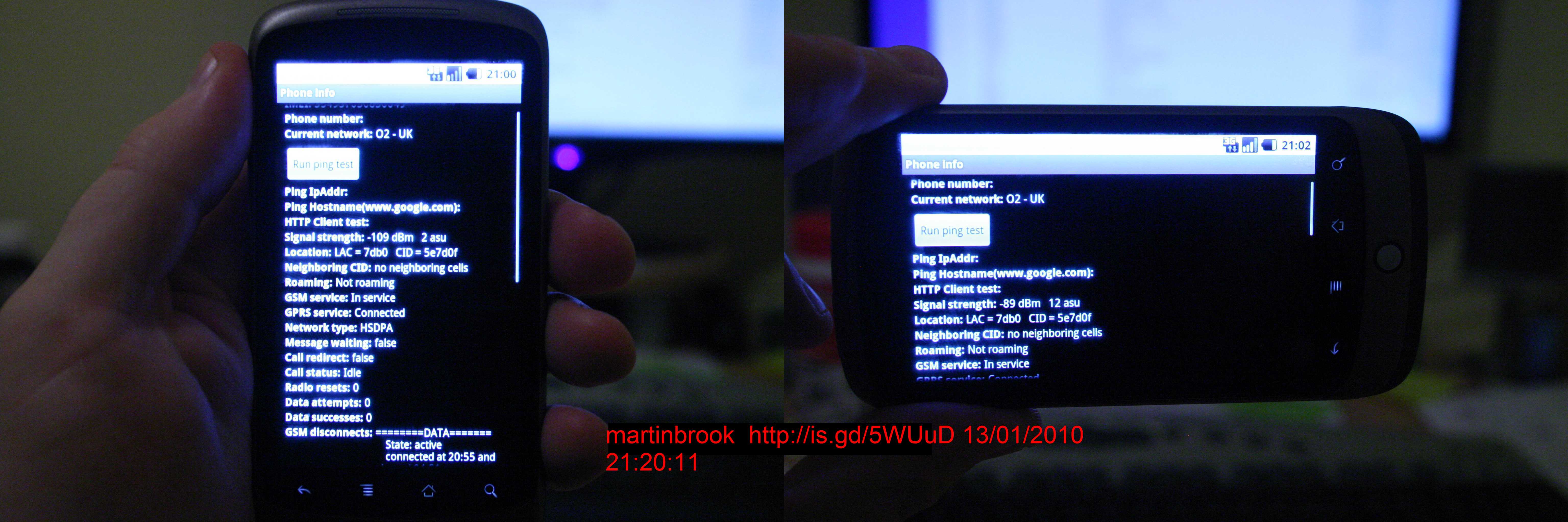

Guest martinbrook Posted January 13, 2010 Report Posted January 13, 2010 (edited) Signal strength is the key as I posted this link http://is.gd/5WUuD on Jan 9th. Same SIM same base station. T Mobile Pulse -89 dBm (cost 175 GBP) Nexus One -109dBm (cost 400 GBP) Go figure. What about this !! 3G Signal Level Portrait Vs Landscape Edited January 13, 2010 by martinbrook
Guest Shuflie Posted January 13, 2010 Report Posted January 13, 2010 What about this !! 3G Signal Level Portrait Vs Landscape Your hand isn't covering the antenna in the landscape picture. :)
Guest martinbrook Posted January 13, 2010 Report Posted January 13, 2010 Your hand isn't covering the antenna in the landscape picture. :) But my Pulse works fine in both orientations as should the flagship Nexus One. :)
Guest Shuflie Posted January 13, 2010 Report Posted January 13, 2010 But my Pulse works fine in both orientations as should the flagship Nexus One. :) Maybe its antenna is at the top?
Guest martinbrook Posted January 13, 2010 Report Posted January 13, 2010 Maybe its antenna is at the top? Maybe, but to design a "superphone" which cannot be held in the natural way in low signal areas is a major failing. YMMV
