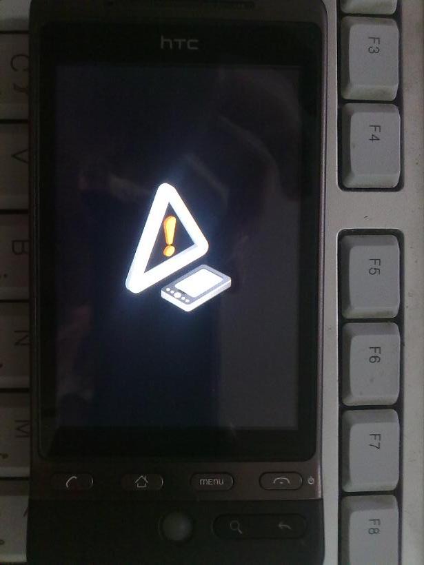

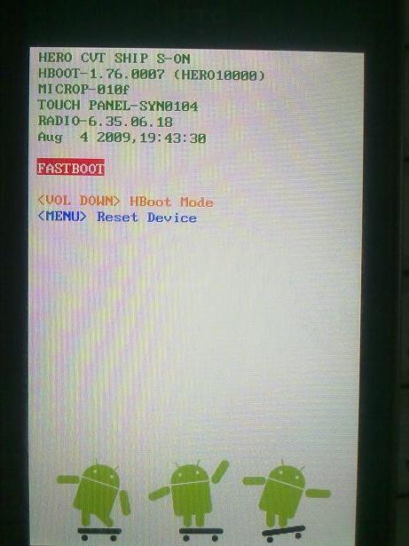

Guest kendon Posted May 14, 2010 Report Posted May 14, 2010 describe exactly what happens when you turn your phone off and then: a) press power :) hold back and press power c) hold menu and press power
Guest siamak5561 Posted May 14, 2010 Report Posted May 14, 2010 (edited) dear Kendon my phone is totally off, a) when i going to power on normally, it stop on HERO logo and i have to put the battery off for turn off my phone. :) this pic when BACK+POWER c) HOME+POWER and at this time Again HOME+POWER Edited May 14, 2010 by siamak5561
Guest zorm Posted May 15, 2010 Report Posted May 15, 2010 That looks hopeful. If you have PC connectivity issues, solve them first. Try this guide. Does your current recovery image support adb? Even if not, you might be able to use fastboot to boot a custom recovery image (get the current AmonRa for YOUR handset) which does include full adb support. From within the recovery image you can execute: adb shell cat /sys/class/mmc_host/mmc1/mmc1:*/cid & thereafter make a gold card & follow existing instructions. Only do this however if you feel you are able to understand & follow instructions carefully. If you make mistakes, such as flashing images intended for other devices, you could well brick your handset.
