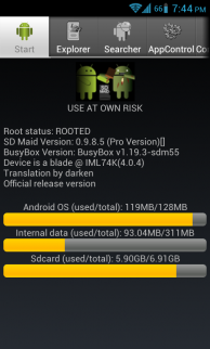

Guest Akash P Posted May 31, 2012 Report Share Posted May 31, 2012 Fresh test build. Repo synced after the android_hardware_qcom_display got sorted. Device + patches + 1, 2, 3 and 4. This is a bleeding edge version and it's not for noobs. Don't whine about bugs, I don't care. And please, don't hijack this thread to discuss about this ROM! KonstaT, This ROM is incredible! I managed to trim it down further so that ROM+Gaaps fit in a 119MB partition. Everything works perfectly here! Amazed at the smoothness of your build! Thank you very much. Link to comment Share on other sites More sharing options...
Guest Hayden3430 Posted May 31, 2012 Report Share Posted May 31, 2012 KonstaT, This ROM is incredible! I managed to trim it down further so that ROM+Gaaps fit in a 119MB partition. Everything works perfectly here! Amazed at the smoothness of your build! Thank you very much. Same here, probably smoothest out there, also gaming seemed a lot less laggy, (pes, nfs) Link to comment Share on other sites More sharing options...
