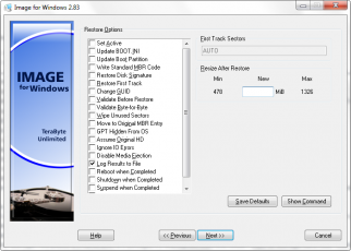

Guest exekutive Posted October 31, 2013 Report Posted October 31, 2013 (edited) OK, finally I made it work. I installed a fresh trial copy of Image for Windows from the website (2.8.3). For some reason it worked on my friend's computer, but not mine. The only difference was running 64-bit version. There was one extra option screen which isn't mentioned in the instructions: I just left the default options. Step #16 says "reopen minitool an if after ext4 partition " but I didn't see a EXT4 partition, only EXT3. So I went back to step 6, re-partitioned the SD card and made sure I formatted it as EXT4. I flashed the ROM image again, and then ran the partition wizard, but the linux partition was EXT3 again. So I guess step 6 is a mistake and you should make it EXT3 instead of EXT4. Step 16 is also a mistake, and you should check the EXT3 partion. The rest was OK. I find the white flashing screen on boot extremely annoying, and I don't particularly like the Chinese splash screen, but I am happy to have Android. Now I just have to fix the "Damaged SD card" problem, and change the ugly wallpaper. Hopefully there are also some widgets for appointments and message. Also, the phone froze while the display went to sleep. I had to pull out the battery and reboot. Cheers, and thanks for the support. Edited October 31, 2013 by exekutive
