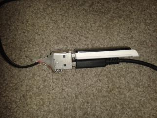

Guest wbrambley Posted November 10, 2014 Report Posted November 10, 2014 I can do this without y cable? Only otg cable? I use a normal USB cable going from phone to a twin port pulled from old PC PCB with the data pins linked together and power pins supplied by an old charger. I don't use an otg cable at all.

Guest wbrambley Posted November 11, 2014 Report Posted November 11, 2014 Thx! You can write this step by step or some pictures? Setup is as pictured. Using normal USB cable, old Nokia charger and twin USB from old dead PC. Link power to one or both ports depending on your preference. I use script to start/stop and check otg.https://mega.co.nz/#!vEwxnADK!oqLY66kdrhPXS8u3Y5F0Hu8K3AtaLMmWfI1eixFqMAQ

Guest wbrambley Posted November 11, 2014 Report Posted November 11, 2014 Thank you so much! But i dont have old dead pc for the usb. What should i do? Kill one! Its fun! If you're like me, I tend to use what I have. I don't know what you have. If you have 2 spare usb extension leads, cut the male plug off and join the leads together. Apply 5v to red/black wires and you should be away laughing.
