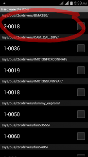

Guest prshkr07 Posted November 23, 2014 Report Posted November 23, 2014 (edited) coolpad f1 accelerometer driver in all their kernels (except laek v3 kernel): Edited November 23, 2014 by prshkr07

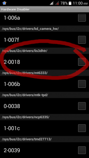

Guest prshkr07 Posted November 23, 2014 Report Posted November 23, 2014 (edited) mmx nitro accelerometer driver in its own kernel (rest all drivers are same): Edited November 23, 2014 by prshkr07

Guest m@nish123 Posted November 25, 2014 Report Posted November 25, 2014 (edited) Guys...so the diff in between mmx nitro a310 and in coolpad f1 is accelerometer....mmx used diff accerelomerter sensor thats why we face accerelometer bug on custom roms... bt via using leaks v3 kernel...we won't face cuz in leaks v3 kernel there is accerelometer sensor of mmx not coolpad f1.... coolpad f1- accerelometer sensor name --->BMA250 micromax nitro-accerelometer sensor name -->lis3dhtr still there is doubt ....in leaks v3 kernel,mmx kernel there is no accerelometer sensor of coolpad f1 then how it works well on coolpad f1 ....but may be in future leaks v3 kernel , mmx ,coolpad f1 user face accerelometer sensor hardware failure...... Edited November 25, 2014 by m@nish123
