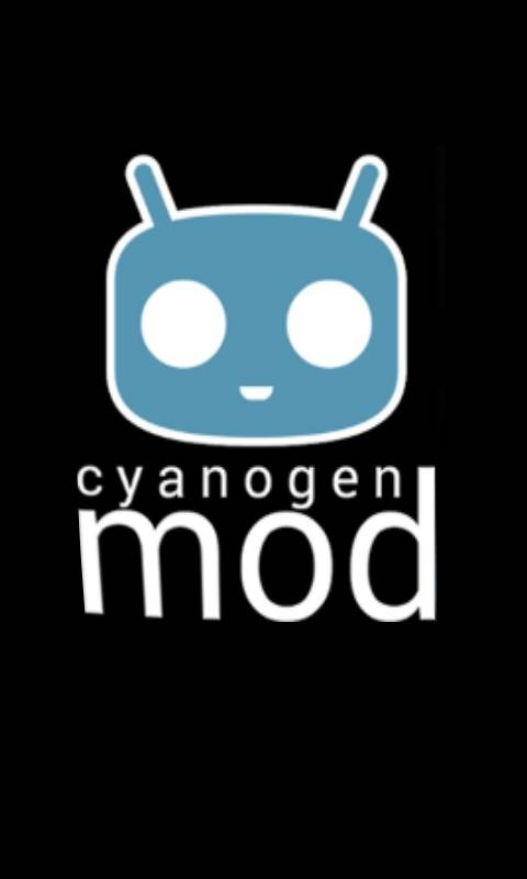

Guest pashapuma Posted January 4, 2014 Report Posted January 4, 2014 (edited) Change bootlogo. Bootlogo - picture that appears immediately after turning on or restarting the phone .You will need root- rights . To change bootlogo: 1) On your phone , using RootExplorer, navigate to the folder / data / cust and create a folder in her logo. Copy the file folder logo oemlogo.mbn 2) Download and unzip the file load_oemlogo.zip and using RootExplorer copy it to the / system / bin. There will most likely already have such file , replace it. 3) Then in a terminal emulator , enter the following command : su load_oemlogo exit (2 times) 4)reboot download oemlogo.mbn 480*854 (for G510) oemlogo.rar oemlogo1.rar oemlogo2.rar oemlogo3.rar oemlogo4.rar download oemlogo.mbn 480*800 (for Y300) oemlogoY300.rar oemlogoY300_2.rar oemlogoY300_4.rar Edited January 5, 2014 by pashapuma
