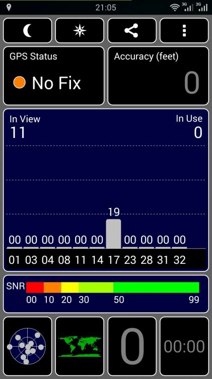

Guest bore89 Posted August 16, 2015 Report Posted August 16, 2015 You have low gps signal as i see from the numbers.Try the following to check if it is a matter of faulty settings or it is a faulty GPS antenna in the phone.Uninstall all apps for faster gps or other gps fix. Resetting your GPSYou need:Mobileuncletools, ES file explorer (or other with root permissions), GPS test1. Rename the next files (if they exist, for backup reasons):/data/misc mtkgps.dat and EPO.DAT and alsο /system/etc/gps.conf2. Activate GPS and go to menu(settings) -> location and we choose ''device only'' (GPS signal only, not WiFi,networks etc)3. reboot4. Find a good position outside with clear view to the sky (or a balcony)5. Start Mobile Uncle Tools and go to Engineer Mode->Engineer Mode (MTK)->Location5.1 go to Location Based Services->AGPS->Enable A-GPS Uncheck it and go back5.2 go to YGPS wait a few minutes untill you have a GPS Fix (the satellite spots will change color)6. Go back and close Mobileuncletools7. Start gpstest and check your location For emui 3 you will need the EngineerMode.apk . Copy it to system/app and reboot.https://www.sendspace.com/file/92xzv6so i tried ..is this better?
